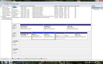

Well...I can't find the "mark as active" option by right clicking.
Does this mean it is impossible to change the partition to active.
I used Vista first, then as after I got Mint 8, I have divided a partition into 2 partitions, and put Mint 8 on one of those newly divided partitions. Mint was on the now as ME2 labeled partition (specially labeled so it is easy to see), and after a while I got Win7 and put it on the current Win7 partition.
Mint 8 got killed several days ago...now this is my partitions lay out.
The 20GB+8GB is inhabited by Mint 9.
I still willing to kill Mint 9 + Grub if necessary to be able to rearrange the partitions.

To answer 1 question, Windows will not boot (can't be marked as active) from an extended/logical partition.
And as you already have 4 "Primary's" on Disk 1 you may be limited in what you can do without some major re-arranging.

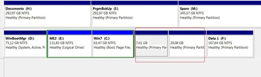

So...this is the screen shot without the right click ;p

Can the stuff on these 2 be moved somewhere?

The problem is that Win7 is on an extended Logical partition which cannot be marked Active.
Conveniently, Partition Wizard CD can also Convert to Primary on the same rightlclick Modify menu where you find Mark As Active if the partition isn't Logical.
Follow these steps to delete old Vista System partition, delete old Linux Logical partition, convert remaining Win7 Logical partition to Primary, then resize it into the deleted partition space to the left so that Win7 is in the preferred lower (left hand) HD address.
Boot PW CD, Select 1 for screen res, rightclick D former Vista partition to Delete, OK.
Next righclick E former Linux partition to Delete, OK.
Next rightclick C Windows 7>Modify>Convert to Primary, OK.
Again rightclick C>Modify>Set to Active, OK.
Then rightclick C>Resize, drag left grey border all the way to the left to take up deleted partitions space, OK. Apply all steps.
Now boot into Win7 DVD Repair console or Repair CD, accept offered repair. Win7 won't start up yet so boot back into Repair, click through to Recovery Tools list to run Startup Repair up to 3 separate times with reboots to write the MBR to Win7: http://www.sevenforums.com/tutorials/105541-startup-repair-run-3-separate-times.html

Barefootkid ran a virtual simulation of the E:Linux sub-partition delete within that Extended partition which also contains C:Windows 7. Once you delete E then it allows you to convert the rest of the Extended Logical partition to Primary which changes E to Unallocated space to match the deleted D:Vista partition.
So there should be no problem then resizing C into all of the space to its left if you follow the steps given.
Ask back any questions.
