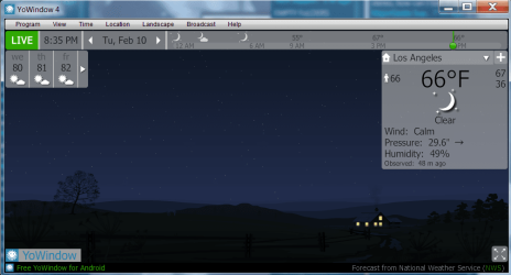

For anyone wishing to try a different one -
YoWindow - Weather with magic
I've been using it for over a year - great customization and always accurate.
